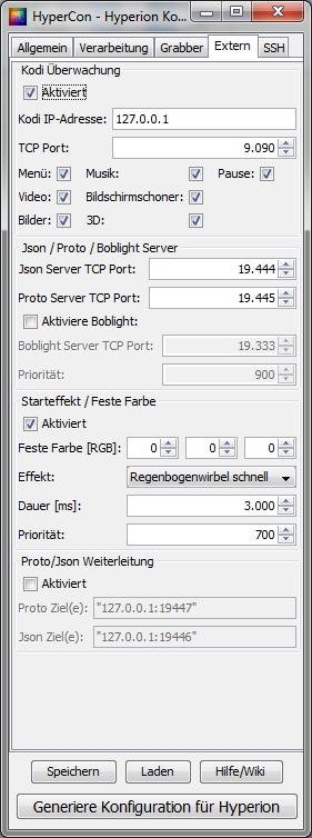

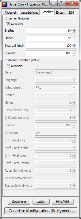

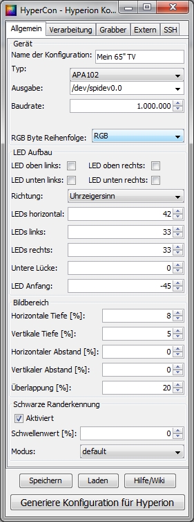

4. hier die hyperion Config
// Created with HyperCon V1.03.1 (11.06.2016)
      "name"       : "Mein 65" TV",
      "type"       : "apa102",
      "rate"     : 1000000,
               "redChannel"      : 255,
               "greenChannel"      : 0,
               "blueChannel"      : 0
               "redChannel"      : 0,
               "greenChannel"      : 255,
               "blueChannel"      : 0
               "redChannel"      : 0,
               "greenChannel"      : 0,
               "blueChannel"      : 255
               "red"    : 255,
               "green"   : 255,
               "blue"    : 255
               "saturationGain"   : 1.0000,
               "luminanceGain"      : 1.0000,
               "luminanceMinimum"      : 0.0000
               "threshold"    : 0.0000,
               "gamma"        : 2.5000
               "gamma"        : 2.5000
               "gamma"        : 2.5000
         "time_ms"         : 200,
         "updateFrequency" : 30.0000,
         "updateDelay"     : 0
   // NO V4L2 GRABBER CONFIG
   // FRAME GRABBER CONFIG
      "threshold" : 0.0,
   // KODI CHECK CONFIG
      "xbmcAddress" : "127.0.0.1",
      "grabAudio" : true,
      "grabMenu" : true,
      "grabPause" : true,
      "grabScreensaver" : true,
         "hscan" : { "minimum" : 0.2595, "maximum" : 0.2881 },
         "hscan" : { "minimum" : 0.2357, "maximum" : 0.2643 },
         "hscan" : { "minimum" : 0.2119, "maximum" : 0.2405 },
         "hscan" : { "minimum" : 0.1881, "maximum" : 0.2167 },
         "hscan" : { "minimum" : 0.1643, "maximum" : 0.1929 },
         "hscan" : { "minimum" : 0.1405, "maximum" : 0.1690 },
         "hscan" : { "minimum" : 0.1167, "maximum" : 0.1452 },
         "hscan" : { "minimum" : 0.0929, "maximum" : 0.1214 },
         "hscan" : { "minimum" : 0.0690, "maximum" : 0.0976 },
         "hscan" : { "minimum" : 0.0452, "maximum" : 0.0738 },
         "hscan" : { "minimum" : 0.0214, "maximum" : 0.0500 },
         "hscan" : { "minimum" : 0.0000, "maximum" : 0.0262 },
         "vscan" : { "minimum" : 0.9667, "maximum" : 1.0000 }

5. Screenshots des Hyperion GUI Tools im Anhang (von jedem Tab einen)

Mit der hypercon.jar kann ich mich per SSH verbinden. Auszug aus der Log:
SSH Traffic:
ssh connected
ssh out:    cat /storage/logfiles/hyperion.log
ssh in:    Hyperion Ambilight Deamon (436)
ssh in:       Version   : V1.03.2 (brindosch-99d9396/d3713a8-1469452981
ssh in:       Build Time: Jul 25 2016 06:54:40
ssh in:    INFO: Selected configuration file: /storage/.config/hyperion.config.json
ssh in:    HYPERION INFO: ColorTransform 'default' => [0; 149]
ssh in:    HYPERION INFO: ColorCorrection 'default' => [0; 149]
ssh in:    HYPERION INFO: ColorAdjustment 'default' => [0; 149]
ssh in:    LEDDEVICE INFO: configuration:
ssh in:    {
ssh in:       "colorOrder" : "rgb",
ssh in:       "name" : "MyHyperionConfig",
ssh in:       "output" : "/dev/spidev0.0",
ssh in:       "rate" : 1000000,
ssh in:       "type" : "apa102"
ssh in:    }
ssh in:    INFO: Creating linear smoothing
ssh in:    HYPERION (CS) INFO: Created linear-smoothing(interval_ms=50;settlingTime_ms=200;updateDelay=0
ssh in:    EFFECTENGINE INFO: 27 effects loaded from directory /storage/hyperion/effects
ssh in:    EFFECTENGINE INFO: Initializing Python interpreter
ssh in:    INFO: Hyperion started and initialised
ssh in:    INFO: Boot sequence 'Rainbow swirl fast' EFFECTENGINE INFO: run effect Rainbow swirl fast on channel 0
ssh in:    BLACKBORDER INFO: threshold set to 0 (0)
ssh in:    BLACKBORDER INFO: mode:default
ssh in:    started
ssh in:    INFO: Kodi checker created and started
ssh in:    INFO: Json server created and started on port 19444
ssh in:    INFO: Proto server created and started on port 19445
ssh in:    DISPMANXGRABBER INFO: Display opened with resolution: 1920x1080
ssh in:    INFO: Frame grabber created and started
ssh in:    KODICHECK ERROR: Kodi Connection error (0)
ssh in:    BORDER SWITCH REQUIRED!!
ssh in:    CURRENT BORDER TYPE: unknown=0 hor.size=0 vert.size=0
ssh in:    EFFECTENGINE INFO: effect finished
ssh in:    KODICHECK INFO: Kodi Connected
ssh in:    KODICHECK INFO: switching to OFF mode
ssh in:    KODICHECK INFO: switching to VIDEO mode
Über die HyperCon.jar kann ich Hyperion zwar stoppen (kill Eintrag in der Log) aber beim Starten hängt sich die Datei auf.
Wo ist der Fehler? Liegt es vielleicht am LED Strip? Ich bin mit meinem Latein am Ende.
