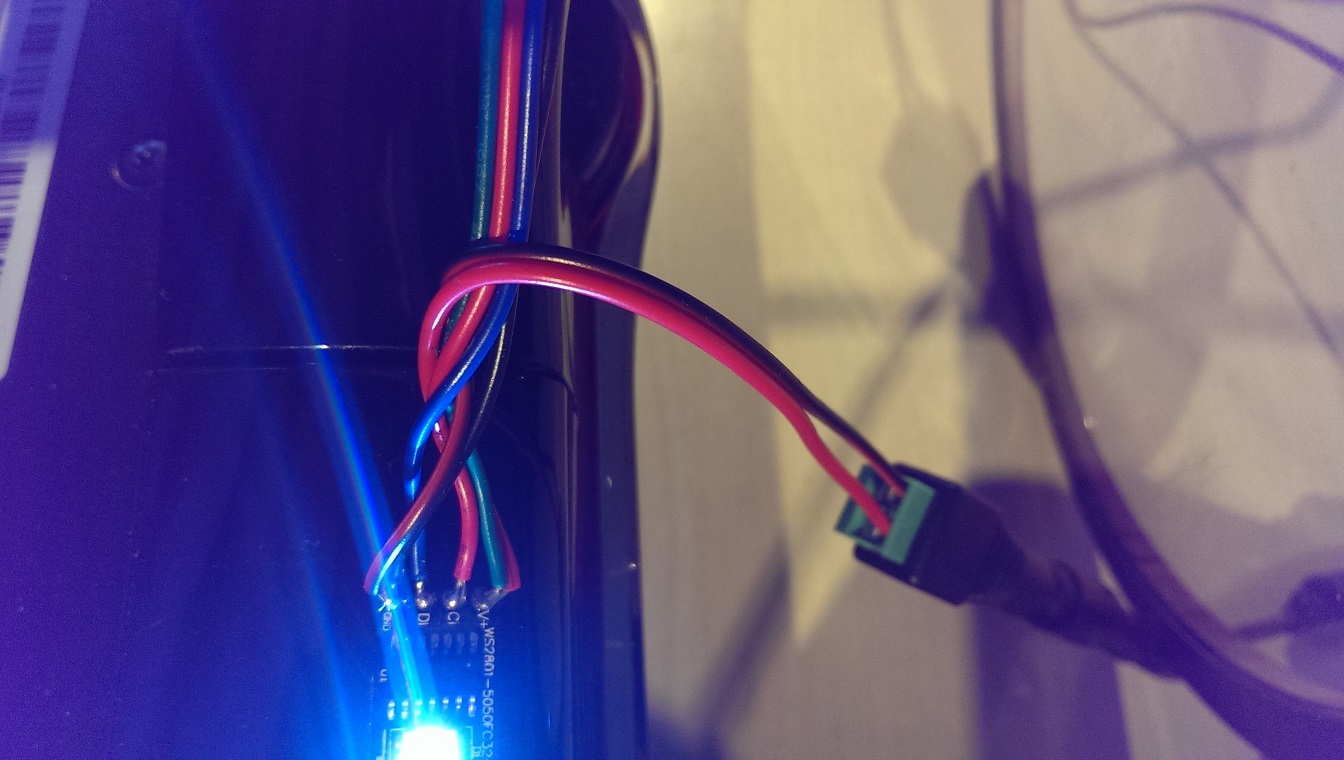

Wenn ich den Raspberry starte leuchten auch alle LED´s. Ich kann aber weder über die Hyperion app die Farben ändern, noch passen sich die Farben an den Bildschirm an.

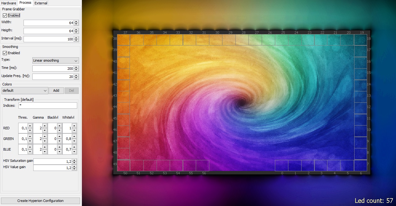

Hier noch mein hyperion.config.json file
"saturationGain" : 1.2000,
"valueGain" : 1.2000
"threshold" : 0.1000,
"gamma" : 2.0000,
"gamma" : 2.0000,
"whitelevel" : 0.8000
"gamma" : 2.0000,
"whitelevel" : 0.7000
"updateFrequency" : 20.0000
"hscan" : { "minimum" : 0.6316, "maximum" : 0.6842 },
"hscan" : { "minimum" : 0.6842, "maximum" : 0.7368 },
"hscan" : { "minimum" : 0.7368, "maximum" : 0.7895 },
"hscan" : { "minimum" : 0.7895, "maximum" : 0.8421 },
"hscan" : { "minimum" : 0.8421, "maximum" : 0.8947 },
"hscan" : { "minimum" : 0.8947, "maximum" : 0.9474 },
"hscan" : { "minimum" : 0.9474, "maximum" : 1.0000 },
"vscan" : { "minimum" : 0.9167, "maximum" : 1.0000 }
"vscan" : { "minimum" : 0.8333, "maximum" : 0.9167 }
"vscan" : { "minimum" : 0.7500, "maximum" : 0.8333 }
"vscan" : { "minimum" : 0.6667, "maximum" : 0.7500 }
"vscan" : { "minimum" : 0.5833, "maximum" : 0.6667 }
"vscan" : { "minimum" : 0.5000, "maximum" : 0.5833 }
"vscan" : { "minimum" : 0.4167, "maximum" : 0.5000 }
"vscan" : { "minimum" : 0.3333, "maximum" : 0.4167 }
"vscan" : { "minimum" : 0.2500, "maximum" : 0.3333 }
"vscan" : { "minimum" : 0.1667, "maximum" : 0.2500 }
"vscan" : { "minimum" : 0.0833, "maximum" : 0.1667 }
"vscan" : { "minimum" : 0.0000, "maximum" : 0.0833 }
"hscan" : { "minimum" : 0.5789, "maximum" : 0.6316 },
"hscan" : { "minimum" : 0.5263, "maximum" : 0.5789 },
"hscan" : { "minimum" : 0.4737, "maximum" : 0.5263 },
"hscan" : { "minimum" : 0.4211, "maximum" : 0.4737 },
"hscan" : { "minimum" : 0.3684, "maximum" : 0.4211 },
"hscan" : { "minimum" : 0.3158, "maximum" : 0.3684 },
"hscan" : { "minimum" : 0.2632, "maximum" : 0.3158 },
"hscan" : { "minimum" : 0.2105, "maximum" : 0.2632 },
"hscan" : { "minimum" : 0.1579, "maximum" : 0.2105 },
"hscan" : { "minimum" : 0.1053, "maximum" : 0.1579 },
"hscan" : { "minimum" : 0.0526, "maximum" : 0.1053 },
"hscan" : { "minimum" : 0.0000, "maximum" : 0.0526 },
"threshold" : 0.01
"frequency_Hz" : 10.0
// "port" : 19333
Ich wäre euch wirklich sehr Dankbar wenn ihr mir helfen könntet, hab keine Ahnung was ich noch probieren soll
